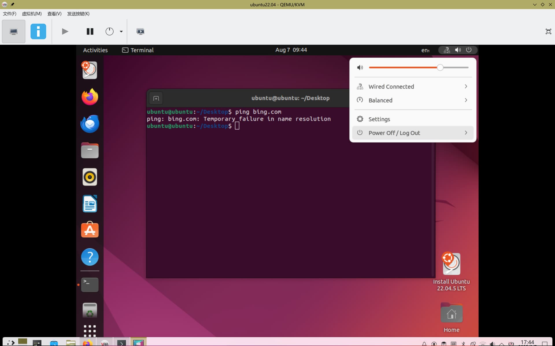

求助:virt-manager 创建虚拟机无法联网
我想使用笔记本上的读卡器,但是驱动只有 5.x 的支持,因此想安装 Ubuntu lts 设置设备直通,但是卡在第一步,虚拟机无法联网。全部默认配置,使用默认的 ‘default’: NAT,但是无法虚拟机内无法联网 :melting_face:
有遇到同样问题的吗? 我还试了 cachyos 上的 virt-manager 默认配置一样无法联网,但是能 ping bing.com 可以 ping 通。

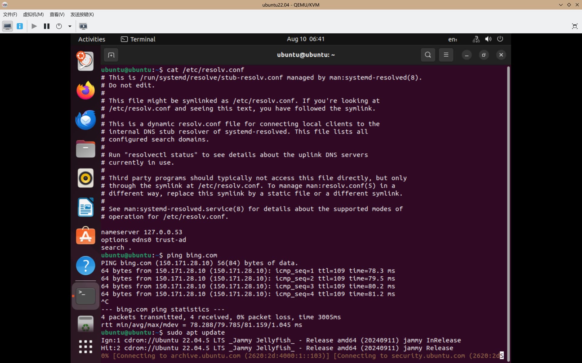

ubuntu@ubuntu:~$ cat /etc/resolv.conf
# This is /run/systemd/resolve/stub-resolv.conf managed by man:systemd-resolved(8).
# Do not edit.
# This file might be symlinked as /etc/resolv.conf. If you're looking at
# /etc/resolv.conf and seeing this text, you have followed the symlink.
# This is a dynamic resolv.conf file for connecting local clients to the
# internal DNS stub resolver of systemd-resolved. This file lists all
# configured search domains.
# Run "resolvectl status" to see details about the uplink DNS servers
# currently in use.
# Third party programs should typically not access this file directly, but only
# through the symlink at /etc/resolv.conf. To manage man:resolv.conf(5) in a
# different way, replace this symlink by a static file or a different symlink.
# See man:systemd-resolved.service(8) for details about the supported modes of
# operation for /etc/resolv.conf.
nameserver 127.0.0.53
options edns0 trust-ad
search .
虽然不能联网但是我可以 ping 通, 貌似是因为虚拟机总是会使用 ipv6
ubuntu@ubuntu:~$ ping bing.com
PING bing.com (150.171.28.10) 56(84) bytes of data.
64 bytes from 150.171.28.10 (150.171.28.10): icmp_seq=1 ttl=109 time=78.3 ms
64 bytes from 150.171.28.10 (150.171.28.10): icmp_seq=2 ttl=109 time=79.5 ms
64 bytes from 150.171.28.10 (150.171.28.10): icmp_seq=3 ttl=109 time=80.2 ms
64 bytes from 150.171.28.10 (150.171.28.10): icmp_seq=4 ttl=109 time=81.2 ms
^C
--- bing.com ping statistics ---
4 packets transmitted, 4 received, 0% packet loss, time 3005ms
rtt min/avg/max/mdev = 78.288/79.785/81.159/1.045 ms
ubuntu@ubuntu:~$
这是 apt update 的情况,无法工作,我这里运营商并没有 ipv6

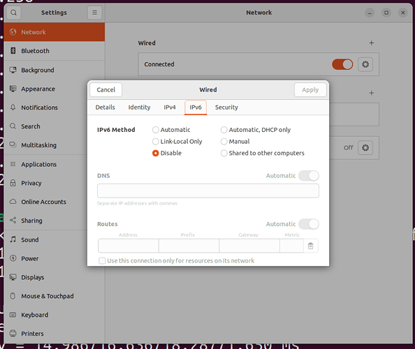

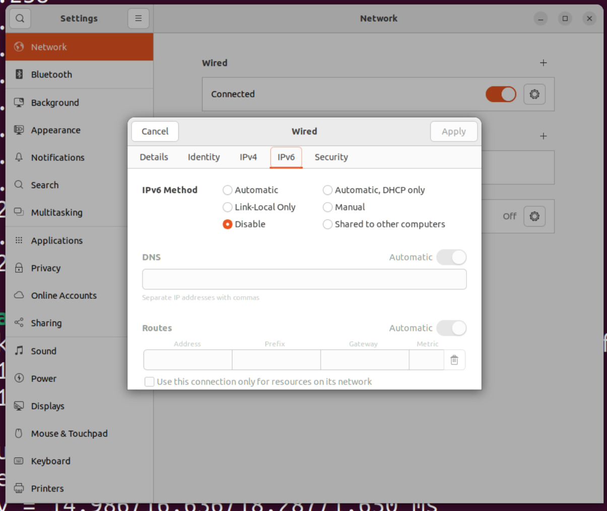

我这里根本没有 ipv6,但是会返回 ipv6,而且 ipv6 已经被我在设置里禁用掉了
宿主机器也是这样的

不知道为什么虚拟机里面会优先使用 ipv6,比如说在使用 apt 时
buntu@ubuntu-Standard-PC-Q35-ICH9-2009:~$ sudo apt update
[sudo] password for ubuntu:
0% [Connecting to cn.archive.ubuntu.com (2403:2c80:5::6)] [Connecting to security
它觉得你的 IPv6 是通的(而且确实通向某个地方了),看看 ip -6 aip -6 r

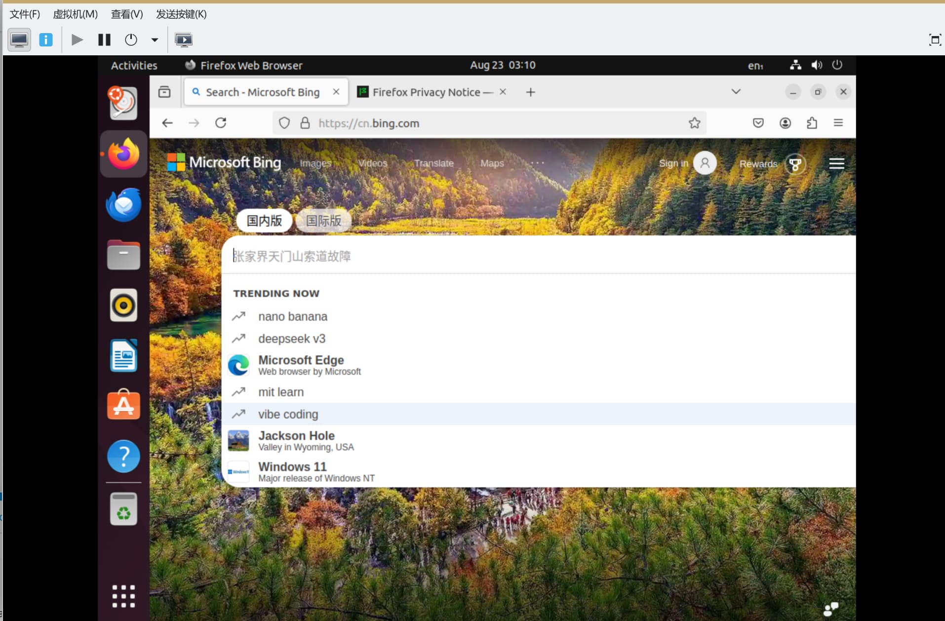

应该是默认的安装脚本的问题,我在这里 archlinux bbs 找到了解决方法
tldr
echo firewall_backend=iptables >> /etc/libvirt/network.conf
